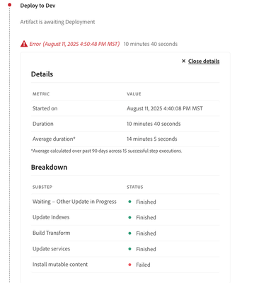

Did anyone had issue with Custom Indexes not getting deployed on AEM cloud pipeline, and failing/error at deploy to dev step. Had followed this adobe official documentation(https://experienceleague.adobe.com/en/docs/experience-manager-cloud-service/content/operations/index... ) and made the changes, the build and deployment are successful in local and testing was successful. But same is not true on cloud.
In the deployment log, one thing we observed is the ui.apps:0.0.1-SNAPSHOT was missing and cloud was unable to find. But in the build log, we can see the ui.apps:0.0.1-SNAPSHOT package was build successfully.
Any leads/help is much appreciated here. 

Deployment to dev log:
 org.apache.jackrabbit.vault.packaging.impl.JcrPackageImpl Refusing to install package com.xxx..... ui.content:0.0.1-SNAPSHOT-cp2fm-converted: required dependencies missing: [com.xxx..... .ui.apps:0.0.1-SNAPSHOT]","orig_time"

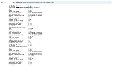

Hi @SantoshSai ,
Quick Update:
Still no luck, after making the above suggested changes, also will try to update any existing AEM OOTB indexing (customize AEM OOTB oak index). Any other ideas/suggestion?
Thabrez
