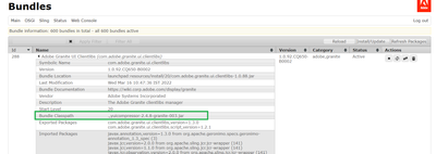

AEM 6.5 uses following yuicompressor-2.4.8-granite-003 for css minification also highlighted in below screenshot -
You will be getting that jar from below location [Bundle ID may vary in your case] -

1. Identify the bundle id associated with yuicompressor-2.4.8-granite-003 via /system/console/bundles
2. Next we need to download the bundle:yuicompressor-2.4.8-granite-003 from AEM-instances\demo-author\crx-quickstart\launchpad\felix\bundle288\version0.1\bundle.jar-embedded [Bundle ID may vary in your case]
3.Please copy that bundle and please keep/paste it inside a separate folder.
4. Then open cmd from that folder and run that command.
