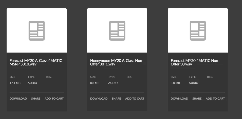

I have created custom Audio Component in Asset share commons in AEM ,everything is working fine except i am not able to get the thumbnail in audio file(.mp3 and. wav).I have done some R&D then I found that Audio files does not have any rendition except original one.So my requirement is that is there anyway that we can add thumbnail in audio file.

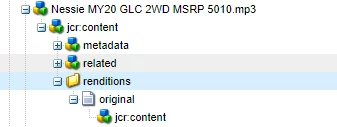

PFB Screenshot of .mp3 node in crx.

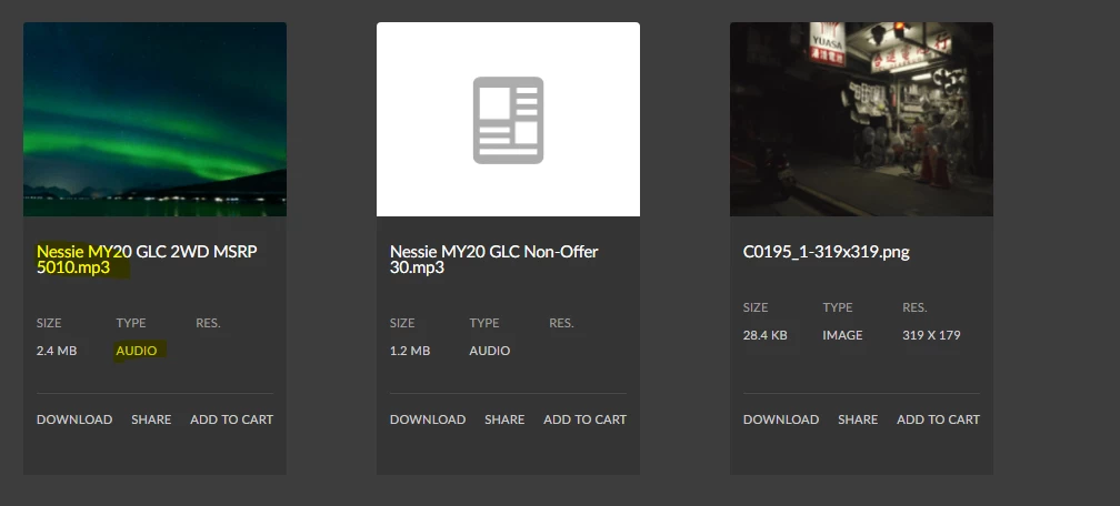

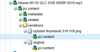

see in above picture there is no rendition except original one that's why it is coming as without thumbnail,When I copy any image and paste it here(manually) then thumbnail is appear in audio files.
but i don't want to do it manually this thing,Can you please suggest some way how can I solve this issue.It will be very helpful for me.

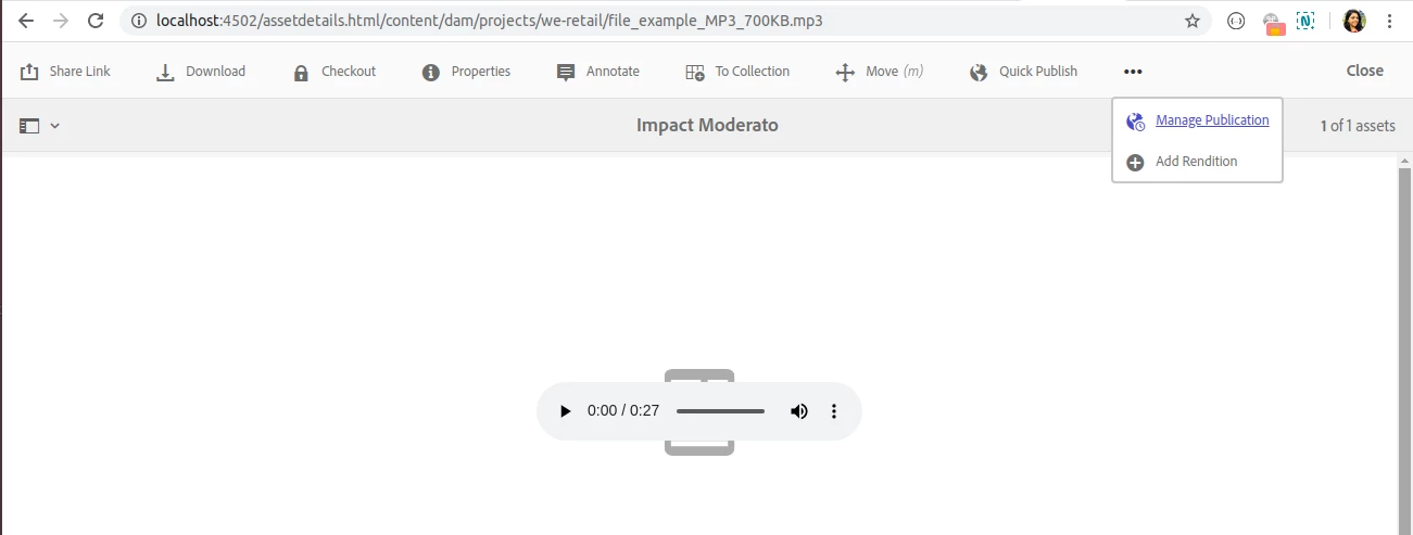

I agree that the manual step of adding it via crx/de is not practical for authors. There is another way to add thumnail via asset console. Follow these steps:
Hope it helps!
Hope it helps!
