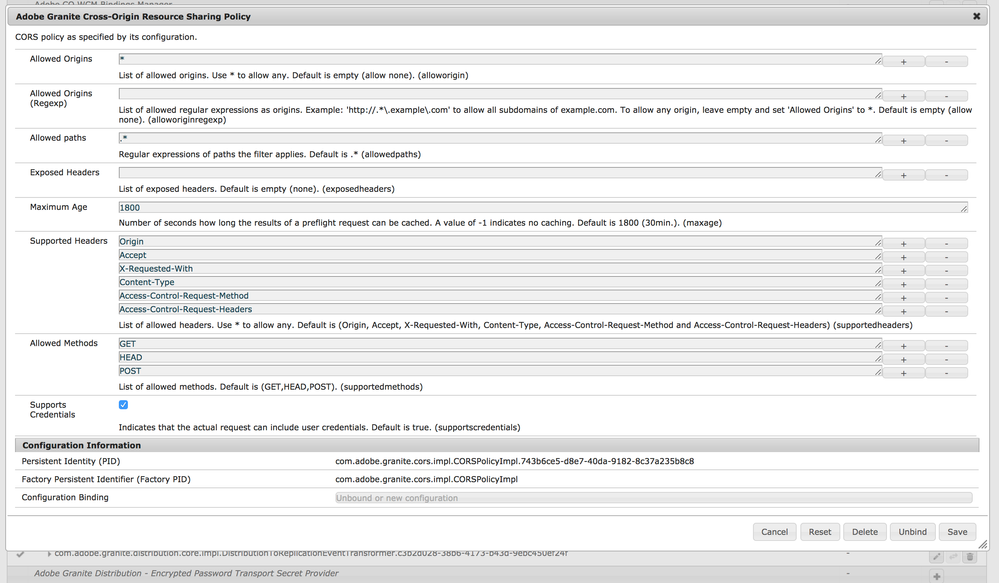

I am running into an issue where I am trying to do some testing on my local machine and I have an author and publish server currently running. For testing I have set the CORS policy to be a wildcard so that I can reference AEM components and html from my local machine. The problem is I am still getting the CORS policy restrictions even though I have changed that configuration to "*" for a wildcard to accept everything.
I was wondering if there are any steps I have to take after updating the CORS policy for it to take affect.

I don't see "Access-Control-Allow-Origin" in supported Headers in this configuration
In addition to that, you may uncheck the supports credentials if you plan to access the content anonymously otherwise add more headers like "Access-Control-Allow-Credentials"
In theory wildcard should work, but you may want to create another entry with exact origin as well "localhost:8885" since I haven't tested it with wildcard

The source doesn't have the headers enabled as mentioned in screenshot. Where did you set the wildcard?
Follow this article to enable CORS at server if you are dealing with local apps accessing author/publish without dispatcher as mentioned in your case-

You don't need dispatcher configs since you access the publish directly.
HI gauravb10066713,
I have it set up like this:
A bit confused by the XML examples, where would I find this configuration?
Adding Access-Control-Allow-Origin in the supported headers did the trick! Thank you very much for your assistance!
