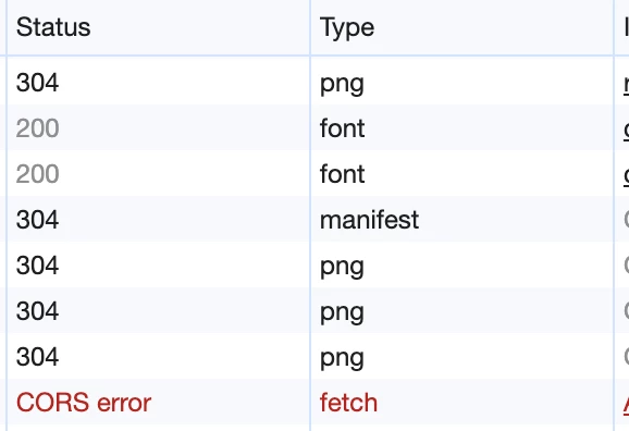

However, when executing this function, I receive the following CORS error:
Access to fetch at from origin 'http://localhost:3000' has been blocked by CORS policy
This issue occurs even though my AEM instance is running locally, and I'm trying to access it from my local React development server.

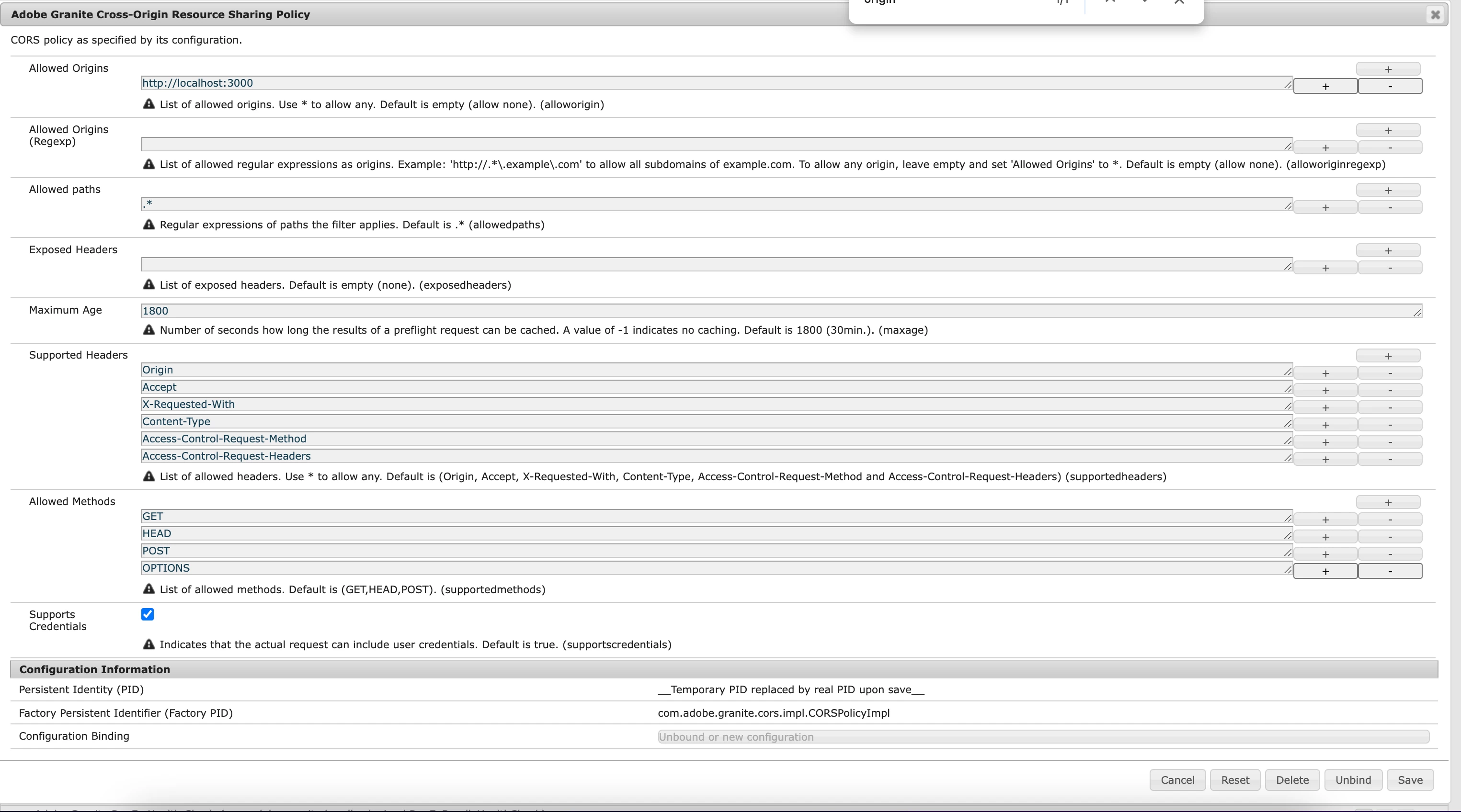

@mosa1 For local testing purpose , you can follow the configuration steps mentioned in this document.
Go to AEM configMgr
  • http://<host>:<port>/system/console/configMgr > Adobe Granite Cross Origin Resource Sharing Policy
  • Add http://localhost:3000 in allowed origins
  • Also update the allowed method (POST) and allowed paths if needed.

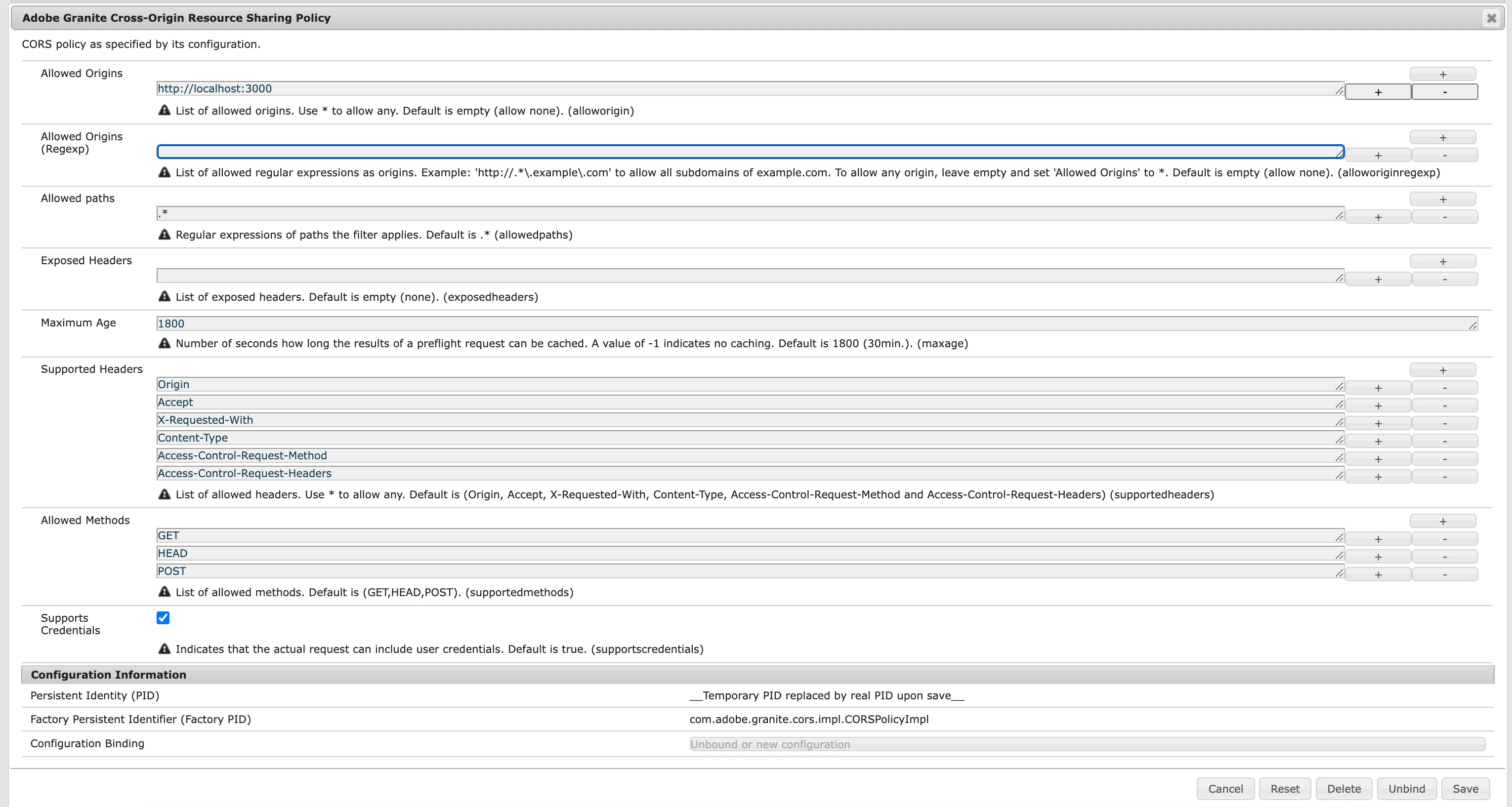

MoSa1Author
February 9, 2024
Thanks for the reply & links.
After saving, I'm still recieving a CORS error.
EstebanBustamante
February 9, 2024
Hi @mosa1 ,
Following what @saravanan_dharmaraj should work, what I see you are missing is to include the OPTIONS method in your "Allowed Methods", this is needed because the React app will perform a pre-flight before the POST call.

MoSa1Author
February 12, 2024
Hi @estebanbustamante
Thanks for your reply and info.
I have added OPTIONS in the allowed methods.
I am still getting the CORS error after adding OPTIONS

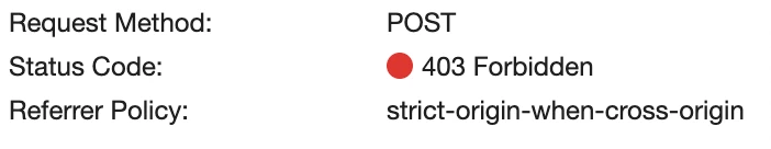

Update: I no longer get the CORS error after adding in a few more things such as Authorization in supported headers, however I am getting a 403.

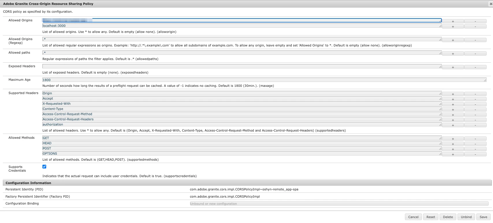

EstebanBustamante
February 14, 2024
I think you are missing the "authorization" header in your config.
Please compare with mine config below, which is working fine with a React app
