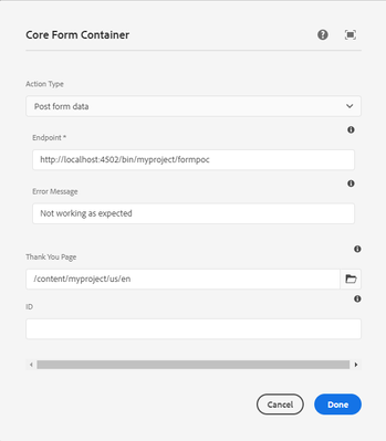

Dialog:

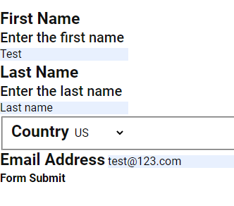

Form:

Yes @arunpatidar. Below is the snippet of my Core Form Container configurations. But, on clicking the submit button, I am getting the above said error with no trace of logs in error log and in my custom log and also in browser network tab. My bundle is in active state with my GetFormDataPoc registered in it. Still not sure on what is going wrong here.
