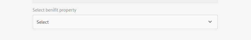

Hi Friends,

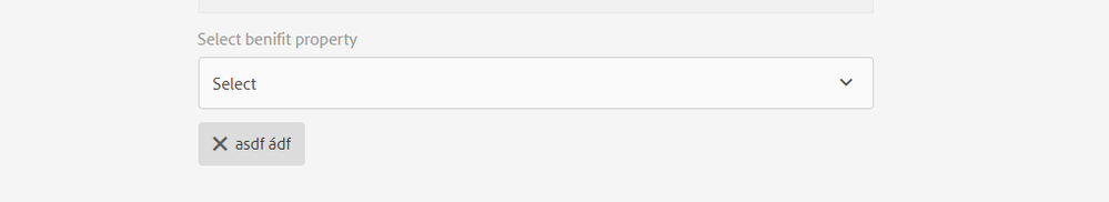

I am using selected multiple field. But it have problem, when I remove all values that I selected and save it. It can't save with none value selected.
Example: I selected one value and save ok.
after that I go to "Views properties" to edit that field and remove selected value.
When I save it comeback again.

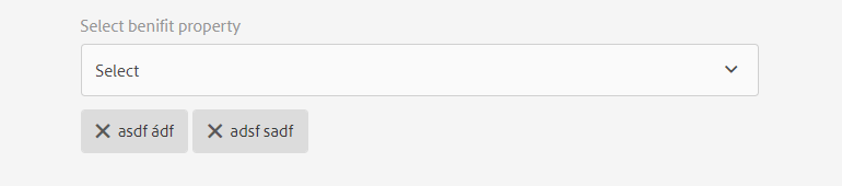

If I selected more than one options and save. After that I remove some option and keep one or more than one selected and save, it work fine. If I remove all options and save it, It come back the option before I remove.
Example: I select 2 options and save ok.
I remove one option and save it work fine.
If I select 2 options and remove all and save, it back to.
My code to bind data into select field and check option fields as below.

I only used DataSource. But the bug still happen. If I remove many options and hole one option it work. If I remove all options it doesn't work. It back to the previous save.
I created a custom field for select and change the render.jsp file of the custom select field. So, I coded a JavaScript function to check the onchange of the select field. It work fine.
%><coral-select id = "abcProperty" <%= attrs.build() %>><%
if (cfg.get("emptyOption", false)) {
String value = "";
AttrBuilder opAttrs = new AttrBuilder(null, xssAPI);
opAttrs.add("value", value);
opAttrs.addSelected(cmp.getValue().isSelected(value, false));
out.println("<coral-select-item " + opAttrs.build() + "></coral-select-item>");
for (Iterator<Resource> items = itemIterator; items.hasNext();) {
printOption(out, items.next(), cmp);
%></coral-select><%!
<script>
abcProperty._onSelectionChange = function(){
setTimeout(function(){
var coralTaglist = $("#abcProperty> [name='./propertiesBenefits']")
if(abcProperty._oldSelection.length == 0){
coralTaglist.append("<input id = \"hiddenProperty\" handle=\"input\" type=\"hidden\" name=\"./propertiesBenefits\" value=\"\">");
coralTaglist[0].hidden = true;
else{
coralTaglist[0].hidden = false;
}, 100);
</script>
