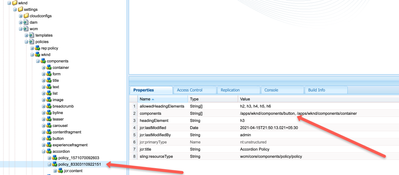

These configurations will be stored under /conf/project specific folder policy node.

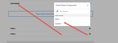

After all configuration when you try to add component in accordion it will look something like below

Like in your example I would like to add the Container component as an item to the accordion but I would like to restrict this Container to allow only adding the same components as for the accordion component (In your example Button and Container). This restriction should work only in the scope of the accordion policy.
Hi @mtobiasz
As per your requirement "I would like to restrict this Container to allow only adding the same components as for the accordion component (In your example Button and Container)" this is already working as you mentioned.
After adding another container into the accordion, it does not allow to add any other component except the allowed components into the container.
