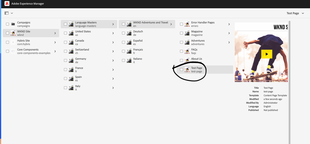

Hi all,
Everyt ime I build my test project (AEM WKND) the pages I create below
/content/wknd/language-masters/en are deleted, I also checked the file
src/main/content/META-INF/vault/filter.xml but to me everything seems as it should, can anyone help me?
