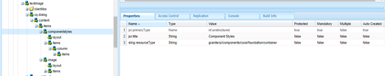

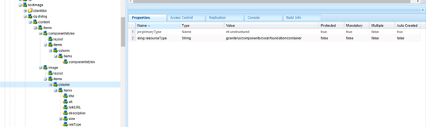

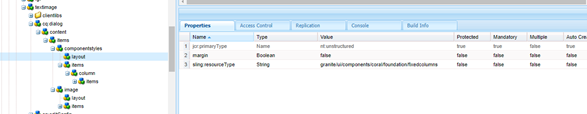

I was migrating the sling:resourceType granite/coralUi3 properties by follwing this helpex article : Migration Guide to CoralUI 3-based — Granite UI 1.0 documentation
Where i was trying to modify the textImage component. This article says that in AEM 6.3 layouts have been removed. so i modified my component as:
I removed the "layout" from starting. But my dialog tabs appears to be broken:
I changed all the sling:resourceType properties inside second tab according to that helpex document and after that this dialogs is showing distorted. Also the margin in the two tabs also not looking good.
Is there problem going on with coralUi3 or something i missed here? Any suggestions would be appreciated.

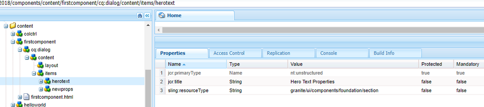

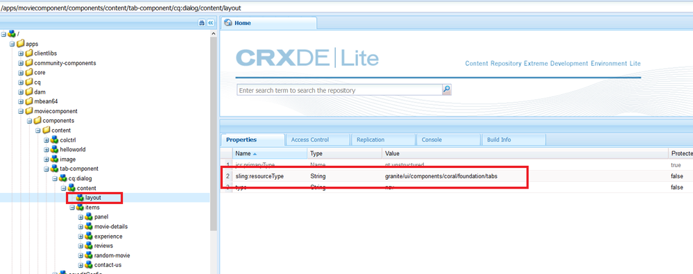

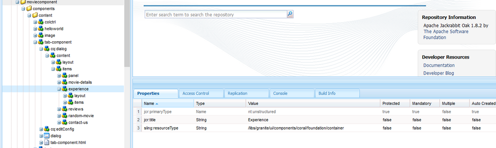

1. I tried to modify this component named "/apps/Lab2018/components/content/firstcomponent" where the layout is "granite/ui/components/foundation/layouts/tabs" which is fine and inside it we have one section (sling:resourceType : granite/ui/components/foundation/section) named "Hero Text Properties" (second image attached)
2. In my case as i want two tabs in the dialog so i created one more section exactly having same properties as that of "Hero Text properties". I was expecting the structure to be appearing in two tabs, as i have two sections in the layout now. But it did not happen. (Third image attached)

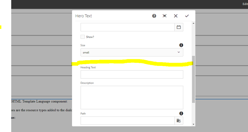

3. It is appearing in a cascaded manner (one section at the top and next just at the bottom of it). First image attched!
I was looking for a scenario with more than one tab in component's dialog specifically the new coral/granite types in 6.3/6.4 versions. Could you please help, how can i address this? It works fine with previous coralui2/granite types, but not here.

We will be releasing the Movie COmpoennt article for AEM 6.4. This component example uses coral/granite tabs that work fine too - see this illustration.
Vistas
Respuestas
Total de me gusta
I will post the link here when its updated to AEM 6.4 in a day or so.

Here is the link with the package that works.
https://helpx.adobe.com/experience-manager/using/aem64_htl_movie_component.html
Also - here is a video that shows Granite/COral component dialog looks good with tabs.

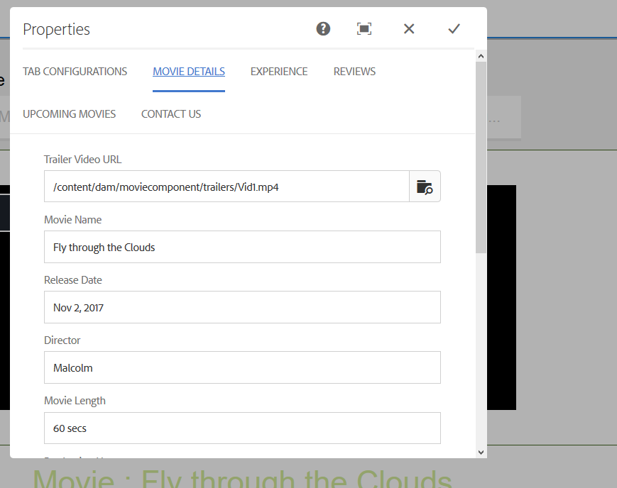

Hi Ashish,

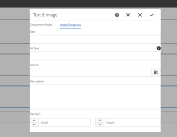

Yes this works. I just now tested the new article which shows coral/granite resource types. See below.
Ratna Kumar.

Thank you so much Scott! for your quick response This works fine now.

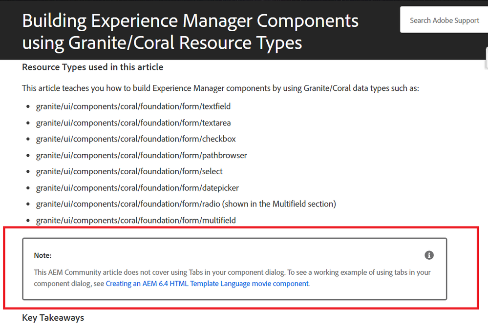

Your feedback to about the 1st Granite Type Article should have a link to the movie one. We will put that in.
Vistas
Respuestas
Total de me gusta
We added this to the 1st article listed here to make it clear:

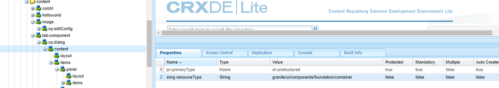

Sorry to ask you so late, but is it okay to have this property(granite/ui/components/foundation/container) instead of (granite/ui/components/coral/foundation/container) for content node under cq:dialog ?
Vistas
Respuestas
Total de me gusta
I recommend using all granite/coral as shown in the movie component - do not mix them up

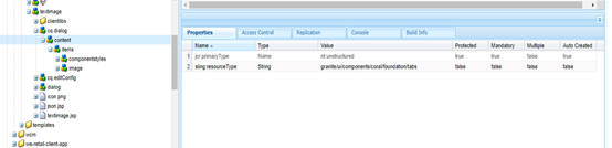

Okay! but the this movie component has the same structure. the tab-component inside the AEM 6.4 package (in that article you shared) is having the content node has (granite/ui/components/foundation/container) instead of (granite/ui/components/coral/foundation/container)
Vistas
Respuestas
Total de me gusta
and if i changethe content node property to (granite/ui/components/coral/foundation/container) it is again showing the cascaded structure of the tabs
