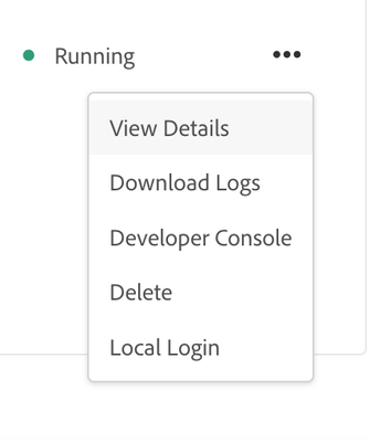

There are new releases that happens on AEM as CS. You can update for the environment. I wanted to say if that is not updated with latest release, you can go ahead and try updating. You don't see the update button on below image since my instance is up to date. Screen Shot 2022-03-03 at 10.20.17 PM.png

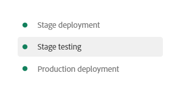

There is no option to create pipeline only for stage. In CM both stage and prod deployment happens through single pipeline. But as you mentioned, there is an option to pause before deploying to production. If you check this, once the deployment is done, you will have to approve or reject the deployment to prod. In this way you can do deployment only on stage and reject for production. Below screenshot for your reference:

After stage testing step is it keep going till deploy to production?
Himanshu Jain
Yes

Meanwhile, you can try updating the server before deployment.
What do you mean by try updating the server before the deployment what exactly are we updating here.
Got it thanks.
