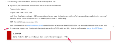

This is part of the security checklist that you should go through in a production env, you can learn more from the links I pasted below, it mentions that only JSON is critical for internal operations, so you should be good. The other renders must be disabled by extra security measures.
https://sling.apache.org/documentation/bundles/rendering-content-default-get-servlets.html
https://experienceleague.adobe.com/docs/experience-manager-65/administering/security/security-checkl...
