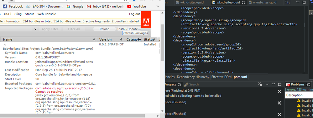

My local AEM 6.3 has the bundle "com.adobe.cq.sightly.cq-wcm-sightly-extension" in the version 1.4.28; it exports the package "com.adobe.cq.sightly" in version 3.1.0.
If your built bundle demands a version range  [2.5,3), it's built against a wrong version of the uber.jar; I also just checked the uber.jar and it has the very same version number 3.1.0 listed for this package.

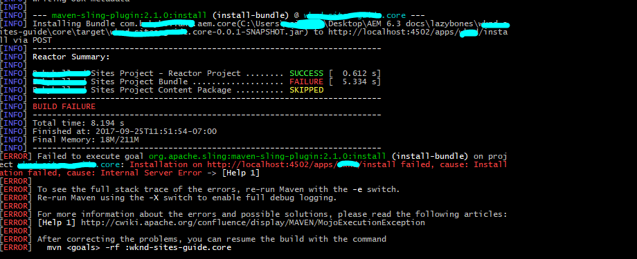

The Maven build fails in the step "install", when "localhost:4502" reports an internal server error. You should check what's the reason for this and fix it. And then try again.
This is not a problem of the maven build itself.

1. [ERROR] Failed to execute goal org.apache.sling:maven-sling-plugin:2.1.0:install (install-bundle) on project testsite-services: Installation on http://localhost:4502/apps/XYZ/install failed, cause: Installation failed, cause: Conflict -> [Help 1]
Root cause: This error occurred because build script is trying to deploying the packet under /apps/XYZ/install directory which actually does not exists.
Create folder named "XYZ" & "XYZ/install" under "apps". Use CRXDE Light to create folders.
2. Remove the <usePut> tag
Source:- Abobe CQ5 – Deployment error of code – MojoExecutionException – Need is the mother of invention …

im actually done, i have installed the package... the one that causing it was the path to the /apps/wknd/install folder.
my problem right now is this one

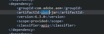

YOu are not building the correct version of AEM UBER. If you are using AEM 6.3 - use UBER 6.3. What version are you using?
im using 6.3
Your project is not picking up the 6.3 UBER. If it was - you would see:

im pretty sure im using 6.3
im going to create another project and see if it works...
is your jar downloaded ?
Jörg
Ran into similar issue.  The cause was found to do with following declaration in the parent pom.xml overwritten uber-jar 6.3.0 declaration.
                <plugin>
                    <groupId>org.apache.felix</groupId>
                    <artifactId>maven-scr-plugin</artifactId>
                    <version>1.20.0</version>
                </plugin>
                <plugin>
                    <artifactId>maven-bundle-plugin</artifactId>
                    <version>2.5.3</version>
                </plugin>
Removing these declarations fixed the issue for me.
