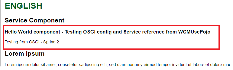

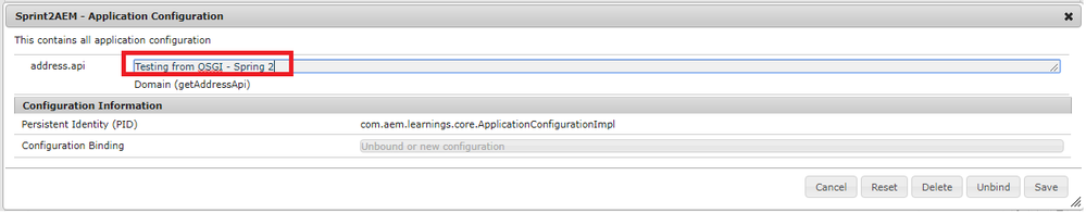

I tried to execute your code in my local (in your original post) and I was able to reproduce your issue of service Object being null.
When I changed the service name in my Impl Class, it works. Adding the complete snippet for your reference.
(in Pojo class, I added a getter for addressApi for testing the value entered via OSGI config)

Great response - we marked that as correct!
Thanks all for response.
Following the code of @vijis31358935, it works.
