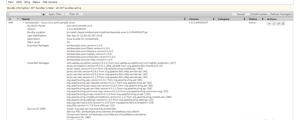

this is my bundle which I uploaded in felix console :

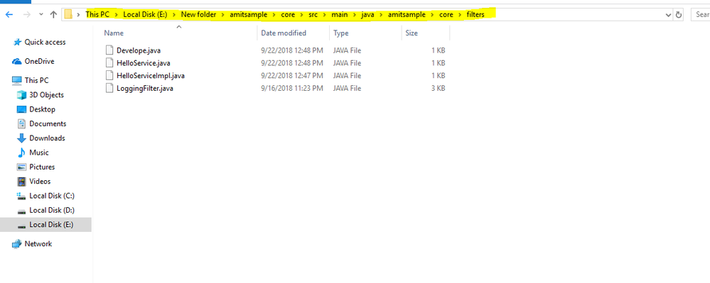

And these are my code:

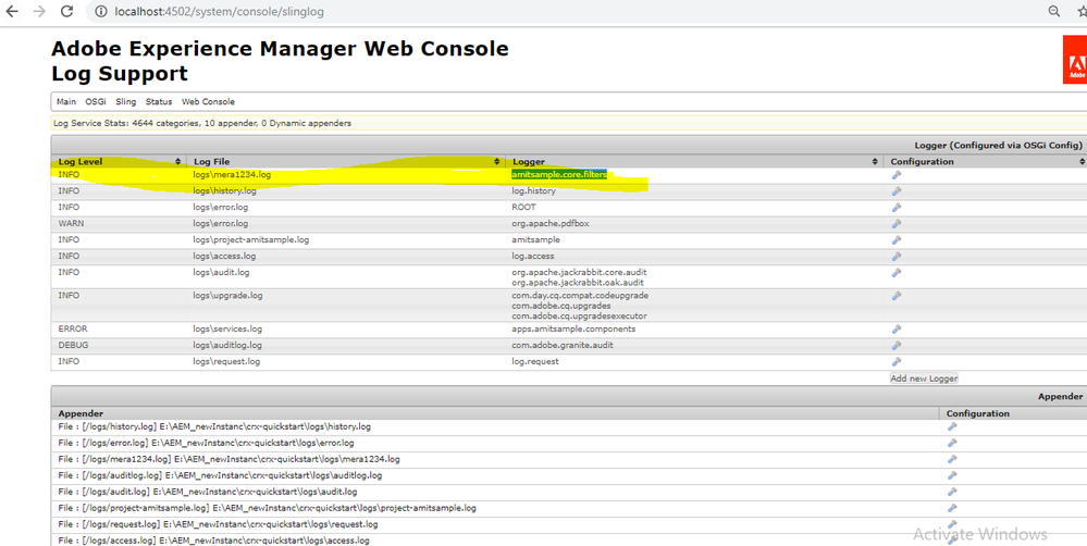

Now I am setting logs to see whether it is working or not but I am not getting anything in my logs and in which page I am dragging and dropping the  component that uses   develop.java (WCMuse class) file thru sightly, There  also no value I am expecting  return "Amitgggg"; this in my page but not getting any idea what is the problem .
