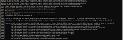

Build Failure while creating the project archetype 29
Failed to execute goal org.apache.maven.plugins:maven-archetype-plugin:3.2.1:generate (default-cli) on project standalone-pom: startup failed:
[ERROR] General error during conversion: Conflicting module versions. Module [groovy-all is loaded in version 2.4.16 and you are trying to load version 2.4.8
Hi @danish_hussain ,
Due to maven-archetype-plugin version 3.2.1, pom file has 2.4.16 version for groovy-all
<dependency>
    <groupId>org.codehaus.groovy</groupId>
    <artifactId>groovy-all</artifactId>
    <version>2.4.16</version>
    <scope>compile</scope>
</dependency>
.m2/repository/org/apache/maven/archetype/archetype-common/3.2.1/archetype-common-3.2.1.pom:      <version>2.4.16</version>
post-generate groovy using 2.4.8 version in below annotation. This is creating conflict and showing the error.
@Grab(group="org.codehaus.groovy"module="groovy-all"version="2.4.8")
https://github.com/adobe/aem-project-archetype/blob/develop/src/main/resources/META-INF/archetype-po...
To resolve this issue - you can update 2.4.8 version in below POM under local .m2 repository.
