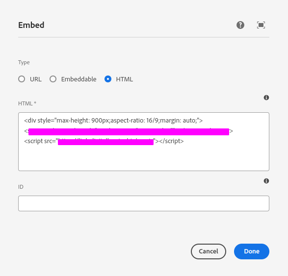

Hello, our client wants to add html code that includes the aspect-ratio style property with the value 16/9 to the embed html like this:
<div style="max-height: 900px;aspect-ratio: 16/9;margin: auto;">
I allowed the aspect ratio for the style property in the xssprotection config.xml and want to allow any value for the aspect-ratio like this
<property name="aspect-ratio" description="">
<regexp-list>
<regexp name="anythingWithSlash"/>
</regexp-list>
</property>
I tried it with the out of the box anything and also added my own anythingWithSlash
<regexp name="anything" value=".*"/>
<regexp name="anythingWithSlash" value=".*|\/"/>
but the result is always
aspect-ratio: 16 9;
 without the slash.
Are slashed removed on a deeper level?

Hi @tarunkumar Thank you for your fast reply.
I do not think this is possible in out use case as editors will add an Embed component like in the Screenshot with code copied from another service and expects that it works. My goal is not keep the slash they entered in the aspect ratio value.
