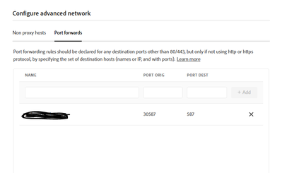

Below are my configuration details.
Configuration: AdvancedNetworking
Configuration: com.day.cq.mailer.DefaultMailService.cfg.json
"smtp.host": "$[env:AEM_PROXY_HOST;default=proxy.tunnel]",
"smtp.port": "30587",
"smtp.user": "EMAIl_USERNAME",
"smtp.password": "$[secret:EMAIL_PASSWORD]",
"from.address": "noreply@sample.com",
"smtp.ssl": false,
"smtp.starttls": true,
"smtp.requiretls": false,
"debug.email": true,
"oauth.flow": false
