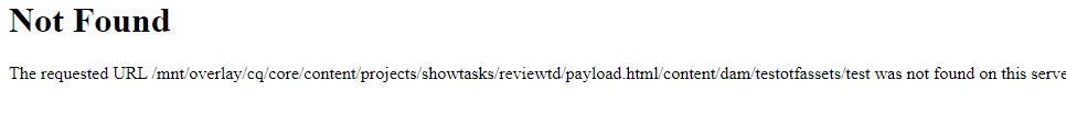

Facing an issue while reviewing an AEM asset.

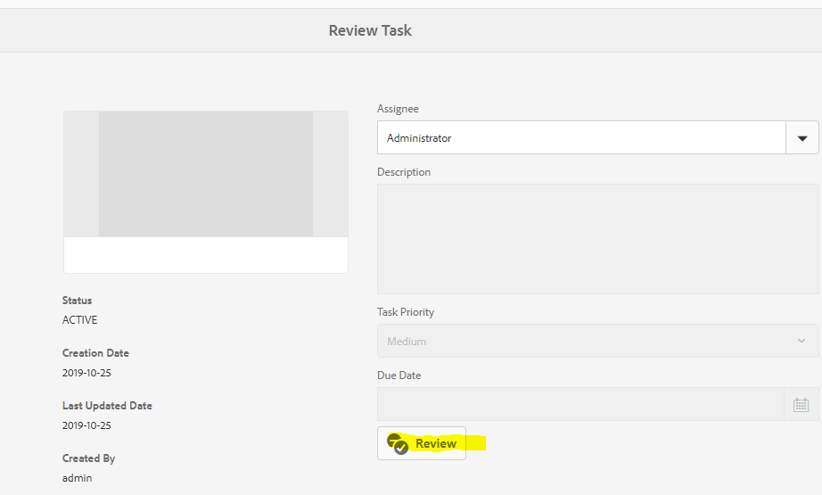

-> In AEM 6.5, created a Review Task for an Asset folder and assigned to Administrator.
-> Logged In as Administrator , Clicked on Notification to review.
-> On click of Review --> throwing below error
Please let me know how can I resolve it.

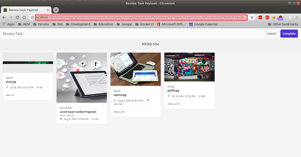

I just tried this on my AEM 6.5.1, without any issue:
Have you looked in error.log?

I too have the same issue as Pavan (despite being admin user and having access to everything). Also not getting any errors in log from what I can see.
Not sure what the problem is.
Did anyone find solution? We are facing the same issue on v 6.5.6.8
Note: It works fine when you logged on to Author instance directly.
The issue occurs only when accessing the author from dispatcher. All the necessary URLs are allowed in dispatcher filter
