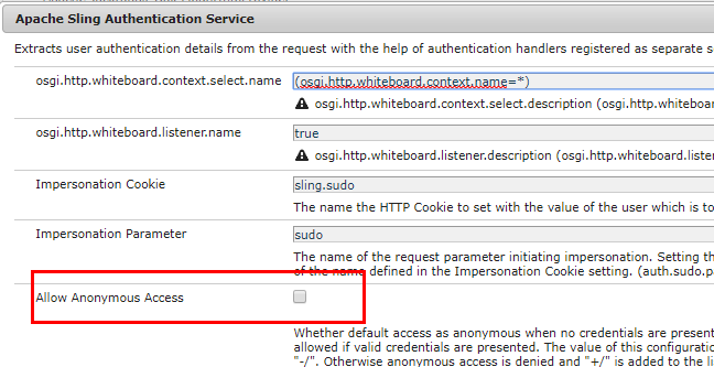

Can you check this particular config once, It should be checked

Click Allow Anonymous User and re-boot the server - see if that helps.
Allow Anonymous User is checked and I reboot the server. Didn't help.
