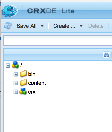

A strange thing I realised is when I log in CRX with both browsers. The one when everything is running looks fine and has all the required folders apps, content, libs, etc.
In the browser where the problem can be reproduced, I see a very reduced version in CRX containing only bin, content and crx folders.

That means, that you are are being logged in into the very same system, with the very same user, but with 2 different browsers, and you get different views?
Assuming, that you access the same system makes me think, that you are not using the same user. The screenshot looks like the system an anonymous user would see when logging in into CRXDE Lite on a publish instance.

Hi Jörg,
Thank you for your answer. You are right, I am not logged in in CRX on the system where I see the problem. So what I realise now is that I do not even need to recompile JSPs. As soon as I log in into CRX the site looks fine. If I log out of it, the header of the page is gone.
So I am with admin when it works and anonymous when it does not work. It looks like a rights management problem somehow. Do you have a hint where to start looking?

I assume that you messed up the permissions on your publish instance. By default anonymous should be able to see some more paths.
