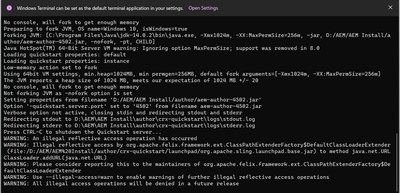

Hi @DEBAL_DAS - This is Suvendu here. I am also facing the same issue. I have already installed Java & maven. Also environmental variable has been set. While double click on AEM jar file from author folder AEM instance is running but not 100%. It seems like pause after 70 or 75%. I have tried deleting the crx folder & run through cmd from the author folder, but no luck. It's already my half of the day finished.
What could be the cause ?
NOTE - System config - Windows 11, 16gb RAM, 512gb SDD, i5 11th gen processor
Below is the message while running through cmd -
AEM Instance running till this -
