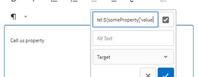

Hi All
   I have a requirement where I need to add a property in the below format for a tel: attribute as phone number in a tag for RTE. Note :- tel: prefix is enabled in Day CQ Link Checker Service, so normal tel: numbers will work fine.
format :- tel:${someproperty['value']}
 The issues I am facing are below.
Issue 1) I need to add something like above as the tel: value in the RTE .
When I add this, I need this to be visible in my href in the HTML. This works fine when I use @CONTEXT="unsafe" , but I don't want to go that route yet. It might be my last resort.

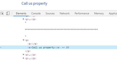

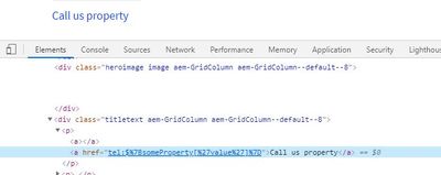

While using @CONTEXT="unsafe"
While using @CONTEXT='html'

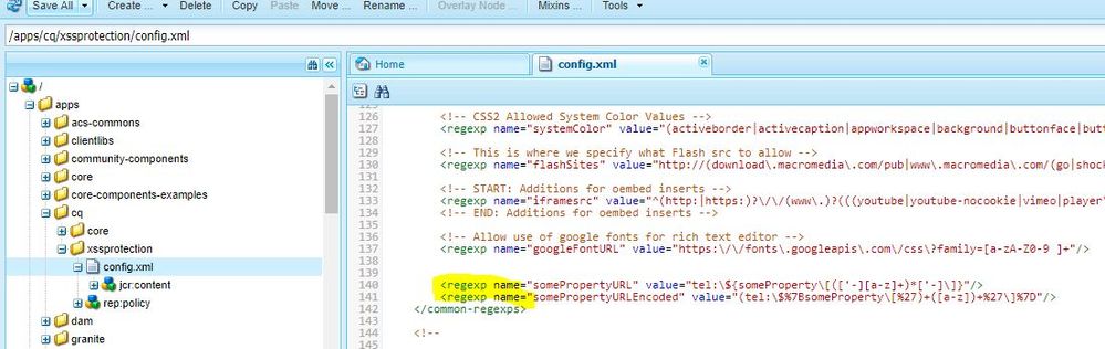

1. Added the below regex to /apps/cq/xssprotection/config.xml

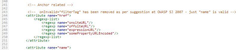

2. Added this to href attribute
Even restarted the instance . Still I am not getting the property rendered in the HTML. I might be missing something here. Any help is appreciated .

@arunpatidar Actually I don't want to print the phone numbers . Another system will read my HTML and replace these properties. So my tel: should have a value something like tel:${someproperty['value']} . Also one thing is correct it is getting saved encoded and when I use unsafe I might have to decode and print it. But I wanted to check if there is any other way other than using unsafe.!?
Hi, Unsafe will not decode the value , in HTML source you will see the encoded value and your 3rd party/consumer has to decode.
