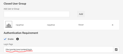

I an novice in AEM and recently have gotten a use case to do gated AEM assets (images, pdf & etc) for external users that do not sits in AEM's user/group, I've studied the CUG authentication features from a few Internet sources, I notice the authentication is mainly performed against the OOTB AEM login module, and seldom elaborate on how it works if I were to provide a custom login page link. Hence, I have a few related queries here, hopefully any folks with similar experiences or experts can shed some light.
  1. From the gated asset folder, possible to put a custom login page link that calling an external login API?
  2. If #1 is possible, assume the external login API authenticated successfully and return an login token, how can I make use of this login token and communicate with AEM that this user has login successfully? and hence can allow the user to view/read the gated asset.
  3. From my knowledge, the permission on CUG seems to work with AEM's user/group only, it might not work with non-AEM's user/group. Wild idea: what if I create a "read-only AEM user/group" so that whenever the external login API come back with a login token, I can treat it as a condition/validation to trigger the AEM login using the "read-only AEM user/group", programmatically thru client-side code (eg: invoke this API "/libs/granite/core/content/login.html"), or AEM already have similar login API exposed?
