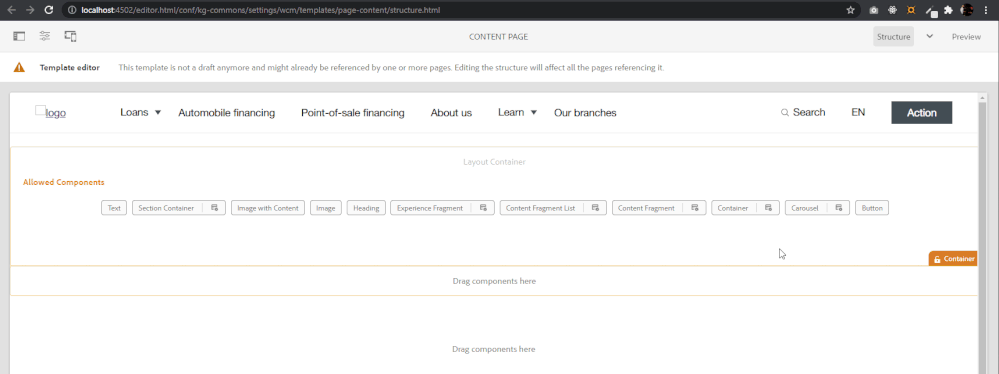

But when I do a clean install with the command mvn clean install -PautoInstallPackage and I check my policies the group was not added correctly, meaning I have to do it manually, as shown below. This is particular annoying because after each install my policies reset so I have to do this again.

5 Replies
Hi @Jeanmaradiaga ,
Filters might be the issue, please try changing the filter mode of last filter to update/replace instead of merge as it won't modify the existing node.
Hello @Kishore_Kumar_  thanks for the reply. I tried updating the last filter to update and then replace but it didn't seem to work. When installing my template still has an empty policy

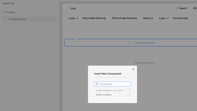

But on a normal content page when I add a Section Container and try to add anything like a text or button that belongs to the Content group I only see this
I know I can manually add it via the Template Editor but my code should work, it doesn't seem to have anything wrong at a a glance.
You have defined the policy but you need to use this policy inside your template as well.
for e.g. I am using teaser policy
Policy defintaion
https://github.com/arunpatidar02/aemaacs-aemlab/blob/9adb6f83726db2dd78a462428034207323f2290a/ui.con...
Used within the template https://github.com/arunpatidar02/aemaacs-aemlab/blob/9adb6f83726db2dd78a462428034207323f2290a/ui.con...
In your case you may have to either defined or use policy with nested wcm resource type like below
<section-container jcr:primaryType="nt:unstructured">
<wcm>
<foundation>
<components>
<responsivegrid>
                <policy_1595870812979
                    jcr:title="Section Container"
                    sling:resourceType="wcm/core/components/policy/policy"
                    components="[group:KG AEM Commons - Content]">
                    <jcr:content jcr:primaryType="nt:unstructured"/>
                </policy_1595870812979>
</responsivegrid>
</components>
</foundation>
</wcm>
 </section-container>
