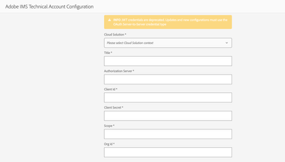

Security -> Adobe IMS Configurations
Adobe IMS Technical Account Configuration

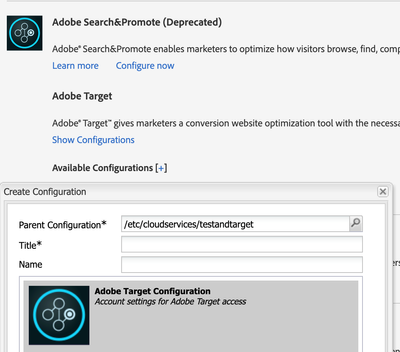

Cloud Services -> Legacy Cloud Services -> Adobe Target Configurations

cloud configuration for target can be found at /etc/cloudservices/testandtarget path.
same here first configure then move it to code.

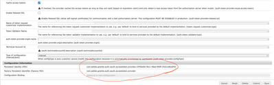

Yes you can add suffix, in-fact if you add the configuration thru IMS console, you can find a hash string as suffix with the PID so that is alway a good practice to have one with suffix if you are expecting more than one configuration .

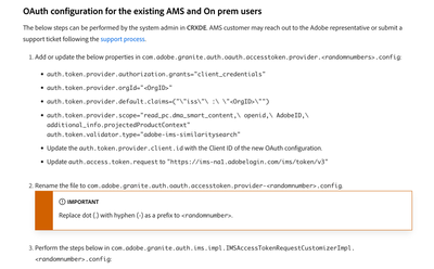

According to Adobe’s documentation, we are required to use a specific naming convention for the configuration file. If I use a hyphen (-) before the <randomnumber>, the configuration does not get installed. It only installs if I use a dot (.) in the name before <randomnumber>, like this:com.adobe.granite.auth.oauth.accesstoken.provider-<randomnumber>.config.
https://experienceleague.adobe.com/en/docs/experience-manager-65/content/assets/using/config-oauth#o...

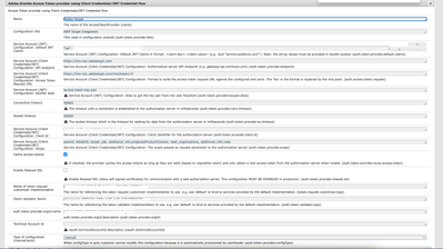

look for in AEM configuration:
Adobe Granite Access Token provider using Client Credentials/JWT Credential flow
as it is there in below image:

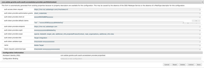

Thank you for your reply. I was able to successfully deploy the configuration. The only issue I encountered was that the 'Secret Key' was missing, so I had to add it manually. I'm not sure which key name I should use to specify the Secret Key as part of the configuration. Could you please advise?
E.g.
for client.id:
auth.token.provider.client.id
for org id:
auth.token.provider.orgId
