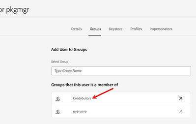

I tried this way and it works
  1. Create a new user as everyone
  3. From Permission, grant jcr:all permissions to /etc/packages sarav_prakash_1-1751206028771.png
  4. Login as the new user and able to create build packages.
