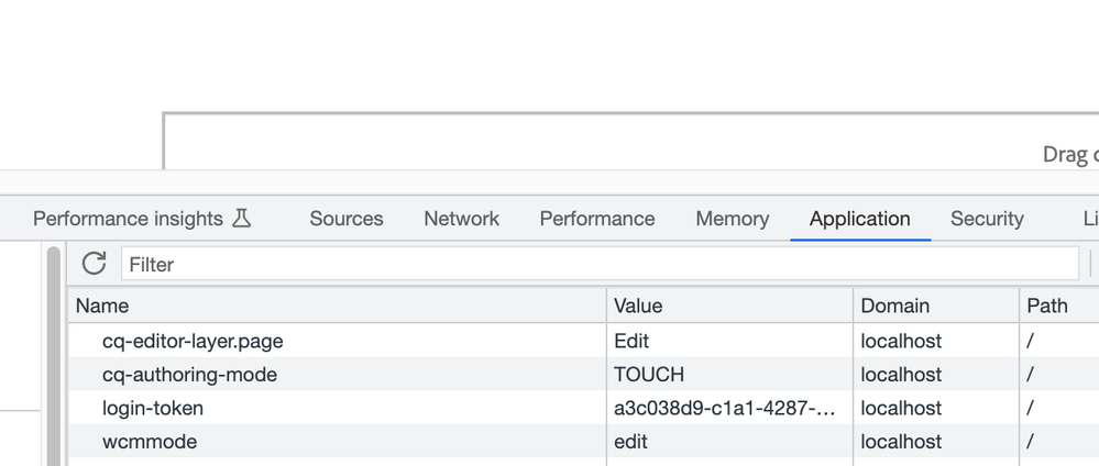

Can you check if you are using any cq:listerner EditConfig in your component. By default the mode does not changed
You can look for cookie to find out the correct mode
AEM LinksLinkedIn
Thank you for answer. The Value of cq-editor, cq-authoring and wcmmode is not change. However, it likes enter the Perview mode.

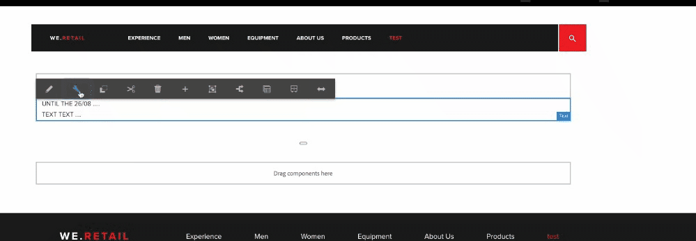

Figure 1. The Elements in edit mode.
Figure 2. The Elements after clicking save and page refresh (Should be save as Preview mode)
Hi everyone, I just found something about the problem. As showing in Figure 1, there should be a Editable div tag in the Edit mode. However, the Element turn to Figure 2 after page fresh.(The clicking in save button in component window trigger the event) The Editable div tag is missed.
