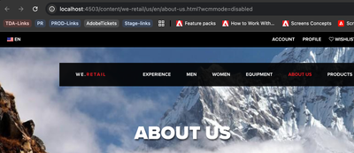

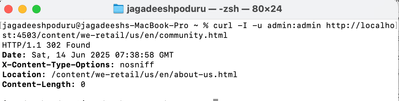

Hi @NavyaVo  I tried on WKND project with AEM6.5.21 version and latest ACS commons 6.12 versions and it worked absolutly fine. I did not even push any thing via code. Once cross check your configuration? or any custom code that is impacting the flow
