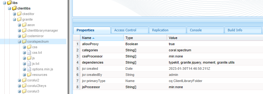

I found the solution myself.
As per my needs and if anyone else is interested in using Spectrum Layout in AEM instead of the CoralUI3, it happens that Adobe calls the library of Spectrum in AEM as Coral Spectrum.
Here are some documentation links:
