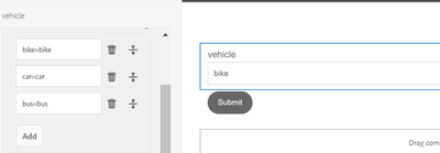

This is my form with dropdown:

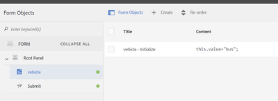

This is the script I am using to set the dropdown value on initialize:

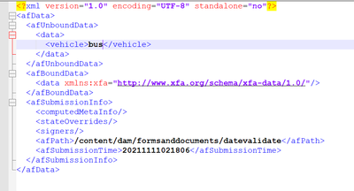

This is the output I am getting on submitting the form:
