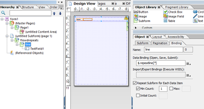

Then the design, a subform for the section and one for the lines repeating and a field
Set the repeat to min 1 - no other setting required

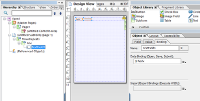

and your field
Not sure where you see this warning - is this a triangle in Designer? Try this approach and tell me if you still get that particular message...

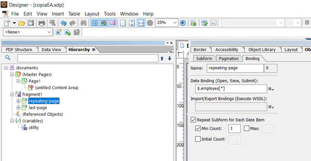

I tried to do as you wrote, in one case it works, in the other it doesn't. I try to explain better (I don't speak good English): I created a form that uses fragments. In the fragments I inserted the binding as indicated. If I preview directly from the fragment files, everything is ok, if instead I run the form that includes them, it displays all the pages only for one fragment. For the other ones it is as if it found only one page and did not see the repetition. Fragments use the same data in the XML. In addition, if from the main document I calculate the number of occurrences of these data in the XML it gives me a higher number than the one actually present, while it gives the correct number if I remove the fragments.
are the fragments using the exact same section of the XML and you have >1 fragment that tries to access the same data in your form? That is not possible - the data gets sequentially "consumed" by the first fragment in the rendering sequence - the other ones will not get the data. That is a fact of the product. You will have to work around that either by duplicating the data in the XML and assigning the tags accordingly or by using script that fills the subsequent fragments. Both is difficult when you have dynamic, varying forms that make use of that one fragment. The number of occurences depends on what exactly you are counting and how. Can you post a screenshot of how your form ist structured in Designer?

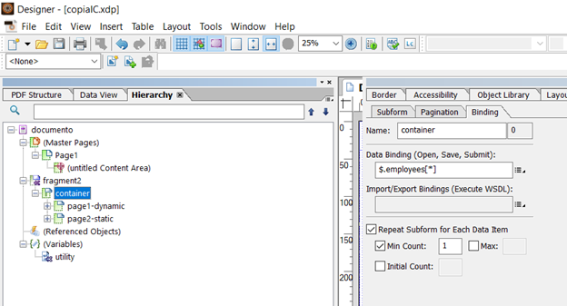

I can't post the image of the form because it is a customer product, I post a similar scheme that I have created now. Below are the structure and related bindings for the 3 fragments that are used by the general form. As you can see all 3 refer to the same type of data in the xml file (any errors in the names don't matter, they are examples)
you basically confirmed my assumption. If you use more than 1 fragment as shown below you run into the "data depleated" situation.

The first repeating subform (no matter if in fragment or directly placed in the design) will depleat your data which is run through from top to bottom during render and never goes back to the beginning. Should subform 1 only read 2 elements, subform 2 would get the one left. But as your subforms dynamically use all employees records subform 2 will never get anything. That you still see one empty has to do with the fact that normally minimum one instance of the subform is thrown but no data for your fields are there.
You could now do the following:
Assign hr1 to the first, hr2 to the second ... - problem here is, that it not only duplicates/triplicates the data but you are not flexibel with your forms - you would have to change the data collection with every form depending on the number of fragments used - and if you don`t know how many would be there at render time - well then things become really ugly and unmaintainable.
You probably have only one option left. Use the data from the dataset directly and NOT bind it. Use a script in EVERY fragment which loops through the data, uses the instance manager to throw a new row and fill the value of each field. This would not deplete the data, and by implementing it consistenly, you do not have differing approaches to filling the fragments.
