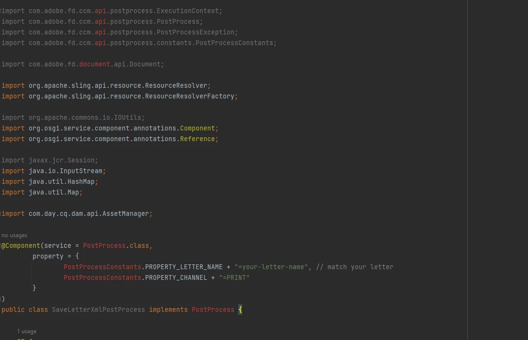

I tried to create a custom post process for AEM Correspondence management, so i used the import
com.adobe.fd.ccm.api but not able to clear the maven dependency error. Can anyone please suggest which dependency do i need to add.
Note: AEM 6.5.22 version i'm using,

Hi @aravindS ,
I am afraid the package (com.adobe.fd.ccm.api.postprocess) used to import the post processor service and relevant objects, is invalid.
PFB[1] the javadoc for PostProcessor service used to define custom post processors.
Also, if possible can you please share the documentation reference that helped in developing this custom service.
[1] https://developer.adobe.com/experience-manager/reference-materials/6-5/forms/javadocs/com/adobe/fd/c....

Hi @usr_ard ,
Thanks for your reply, my intention is to enable / create a custom code which needs to trigger while submit the Letter.
And i have to select the code in the dropdown here.
Can you please share me possible sample code. Thanks

Hi @sharoon ,
Thanks for you comment.
I followed the same as per the article. Not getting my custom WF method. Still that dropdown field is empty.
@aravindS , please log a support ticket with details to sort this out.
