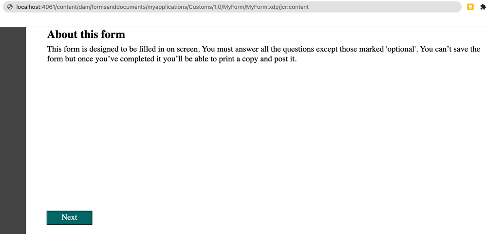

In order to xdp to be rendered correctly, I have a custom lib which contains fragements for xdp config/ref to be used, so ultimately the xdp will become to a webform user then can fill and submit, then pdf getting generated
e.g say i have something like this http://localhost:4061/content/dam/formsanddocuments/myapplications/Customs/1.0/MyForm/MyForm.xdp/jcr...

If you look at it's usehref path, it is pointing at  ..\..\..\****** , so it is reading the render fragment from :
which does its job correctly.
