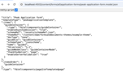

I should say when I include the folder path, I get some kind of JSON - but this doesn't look anything like the Adaptive Form Schema I uploaded.
http://localhost:4502/content/forms/af/application-forms/peak-application-form.model.json
