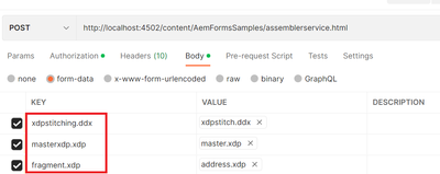

add the following entry
/content/AemFormsSamples/assemblerservice
in using http://localhost:4502/system/console/configMgr
one of the links has the sample ddx and xdp. Please use those to test. The package has jsp code that you need to deploy using package manager
Then using postman make a POST request to the endpoint as shown in the screen shot using the sample xdp and ddx

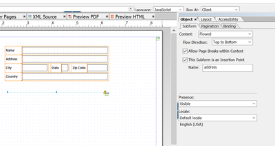

I am following the steps to create insertion point from this Adobe doc : Guidelines for Dynamically Assembling Customized Forms and Documents (adobe.com)
i am attaching screen short for your reference.

live cycle designer 11 to design XDP and AEM 6.5.
please suggest me to insert insertion point in Designer and  use insertion Point through AEM 6.5  AssemblerService.

I have it working. will send you the sample code soon
https://acrobat.adobe.com/link/track?uri=urn:aaid:scds:US:ee24962e-caea-4e8b-863b-2534e7f35386
https://acrobat.adobe.com/link/track?uri=urn:aaid:scds:US:df70a402-0fbc-4be7-8586-db0bf3a8879a
