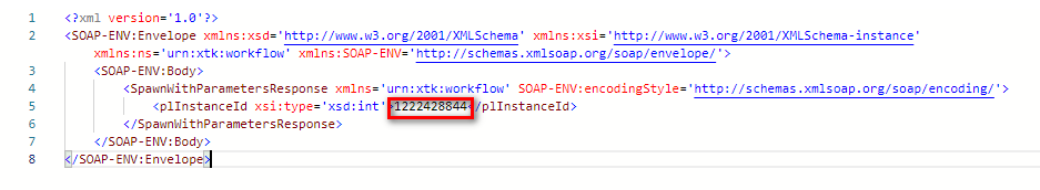

Try the below. That should work.
Thanks for the reply. I have tried the xtk:workflow Spawn method, however whilst this creates a new workflow from a template, it also starts the workflow. I could set the workflow template up to have a disabled start activity, and this does work, however it also creates workflow logs which seems to be a bit of a hack.

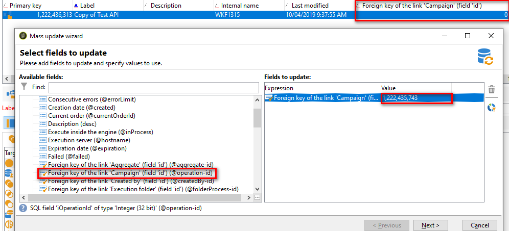

Ideally, I want to replicate the functionality of the console, where a new workflow can be automatically associated to a campaign:
Hi nigeld92054100,
I used the same request that you've used. It works! You need to link the campaign id to the workflow template. However, I was able to create only one workflow in the campaign using this api call. If I try to execute the same api call again, that didn't work.
Thanks, but I'm not sure I follow ![]()
You had to manually update the workflow template with the campaign id? And then when you executed the CreateWorkflowFromModelId method it automatically assigned a new workflow to that specific campaign?
I could not replicate this behavior. Also, I want to be able to create a new workflow from a template for any campaign, not one specifically assigned to a campaign object.
Do you know of any other way to create workflows from a template and assign to any campaign? Other than Spawn (+ derivatives) or CreateWorkflowFromModelId? There must be a way or it wouldn't be possible through the console either.
