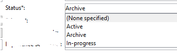

I have an input form, where I have a drop down field. If the value of this drop down is Archive, I want to make the form read only upon saving the form.
Also, if the value is Active, then I want to make a few fields on the input form read only. For example, if the Status is Archive, then make the Message Code field Read Only.
