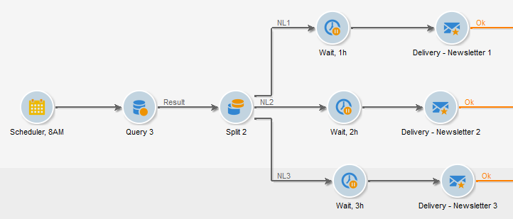

How to configure journey/WF to launch on a specific hour or time, not specific day, not using waves
My team is looking for an option to launch newsletters in a specific hour, like when we launch the workflow, those Newsletters to launch at specific hour, like an schedule but we use schedule to program the whole WF, we are looking for a solution to send those Newsletters in separated hours in the same day when schedule starts.
Day 1 scheduled at 8 o clock of the morning, send NL 1 at 1+ hours, NL2 at 3+ hours (not using waves)...
Is that possible? what can we do to simulate this, or we have to create multiple WF with multiple schedule...
Thank you.
Hi @AdobeCampaignProxd ,
You can use Wait activity before Delivery activity.
In Wait activity, define how much hour/time you need to wait for the next activity to execute.
To know more about Wait Activity - Documentation

Thank you Partha, looks clean and simple, we are gonna test this solution
