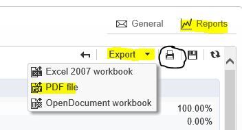

We are facing an issue while exporting PDF Reports of Email deliveries since last month in Adobe Campaign Classic. While exporting it waits about 2-3 minutes to generate the report and then we receive a pop-up window for saving the file locally but file downloaded locally will be having null size (0KB size). This file doesn't holds any content and it can't be opened in of the pdf readers.
But on the other hand for the same email delivery we are able to export it as Excel. There is no pop-up error messages coming in Campaign rich-client console.
Note here we are able to export and download to Excel reports in both xlsx & ods format without any troubles
One strange behaviour is like we are able to get it saved locally in pdf format using the print option (using the circled print button).
