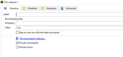

Hi @rudraPraveenKumar ,
Please try using the File Collector and in the Directory Path, please give the full path of the Directory where the Input files are present.
Also, give the type of files you want to read in the Input filter (Example : .csv) as shown in Screenshot.
If you untick the Option "Stop as soon as the file has been processed", then all the files with that filter will be picked in that run.
Also in the File historization Settings, Please give the Archived Folder's Full Path where you want the files to be stored after processing.
Pravallika.

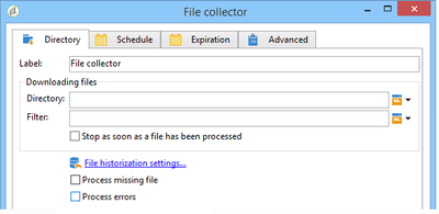

file_collect_edit.pngHi @rudraPraveenKumar
You can use File Collector activity to load multiple files from SFTP and can configure directory and the filters to fetch the correct files.
Hope this helps.
Amit
Pravallika.
