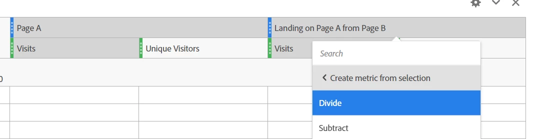

Once you create your Freeform table, you can stack your segments with your metrics like so:
Then you can create ad hoc calculated metrics by selecting the metrics (and segment) and right clicking to "Create Metric from Selection", then choose "Divide"
After you make it, you can edit it to adjust the name, display as Percent, and make sure the math was done in the correct order.
Please note, sometimes when you have multiple metrics stacked under a single segment, the Create Metric from Selected will use the first metric instead of the selected one... if that happens, just temporarily move stuff around to make it one metric per segment until you've made the calculated metric, then put it back... Or create a whole copy of the table to make the calculated metrics in, then drag those back up into the proper table... then delete the temp table when you are done.

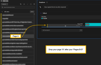

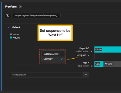

Hello @asdf12341z ,
This might work:
Step 1 -
Step 2 -
Step 3 -
Step 4 -
Step 5 -
This should allow you to see who is coming from Pages B-D (as a combined possible locations segment) and arrived to A on the next hit (meaning that they clicked on something that sent them to Page "A". )

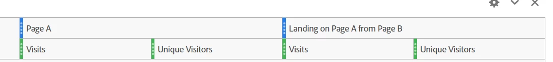

What I was actually hoping for (and sorry if the title is confusing) is to get these same numbers but in the freeform table, because I'd like a way to create summary numbers and conversion rates that are easily and immediately viewable for the users.
Basically I'd have a time dimension, then Page A as the split by visitors and visits, then in the other columns, visits and visitors to Page A from B, then from C, D, E.
I have attached a screenshot of what I envision the output would look like.
Thank you once again for your suggestions and help, it is very much appreciated.
