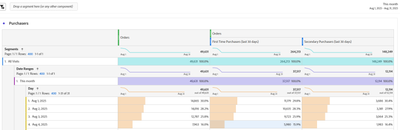

Applying this segment to the reports will give all the first time orders in the look back window, even those that aren't in your reporting window (the calendar set timeframe).
To only show the data in your reporting window, you will need to use a date dimension to filter the data to the specific window of time you want to report on. Example of this is below:

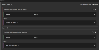

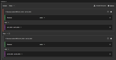

Hi, thank you again for your support.
Based on your guidance, I created the segment like this. Would you mind taking a quick look and letting me know if it seems correct?
Level 6
The one I mentioned is at the implementation level.
The segment you are creating is an adhoc one and however it might work as per the logic I see. You are trying to see the purchase comparing months whether it exists or not.

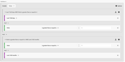

Approach & Experiments:
Experiment 1:
I created a segment to identify users who were active in both the last 7 days and the previous 3 months.
This allowed me to subtract that group from the total visitors during the last 7 days to isolate the desired audience.
Findings: This method worked as expected when validated against the raw data.
(For your case: it would give you the visitors who order in both the date ranges, and you can subtract these users from the total user who purchased in the later date range)

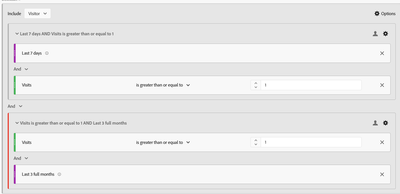

Experiment 2:
I created a segment for users who were active in the last 7 days, and explicitly "EXCLUDED" those who were active in the last 3 months.
Important Note: This method only works accurately when the date range selected on the analysis panel includes both timeframes (i.e., the last 7 days and the prior 3 months).
Regarding Your Segment (Based on the Screenshot You Shared):
From what I can see, using the "THEN" (sequential segment) logic might not be suitable for this use case.
That’s because you’re trying to filter users based on two separate date ranges, rather than defining a sequence of actions over time. Sequential logic is typically useful when you’re tracking event order, like users who did X and then Y.
