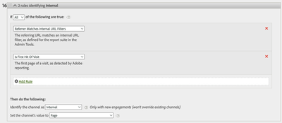

it depends on how you set up your Internal Marketing Channel and whether these sister domains track into the same report suite or not.
By default, it will looks somewhat like this. Meaning, should the sister domains track into the same report suite, you will not have a Marketing Channel Instance because the visit is not the first Hit of the session.

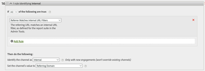

You could potentially tweak this a little to always classify this kind of traffic as Internal and store the Referring Domain in the Marketing Channel Detail instead.
