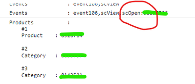

For example in this screenshot I can see scOpen fires but how to find which rule in adobe launch fires it. omnibug shows just the variables which gets fired.
