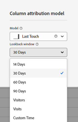

However, you could apply custom attribution models to Tracking Code or Custom eVar to see farther back than their set "attributions", if you needed that:
