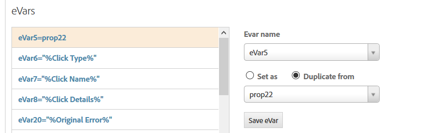

Hello Adobe Community,
We just noticed that since july (well yes a little bit late, but holydays and all that...) one of our evars was capturing a wrong value in Adobe Analytics as : "d=c22"
Omnibug logs show the same, but If I recall alright, this was something normal in this type of tools, and the "d" stands for Dynamic.
The config shows this in the DTM , there should not be any problem - spetially since the prop22 has not any problems and the Data of this one is alright.
Has anybody had had this problem too ?
I cannot  find what is causing this, and why it started in mid july !
Please some help on this !
Cheers !
M.
Dynamic variables are best used to help keep image request lengths down.
If you're getting the literal value 'd=c22' in reporting and you didn't make any changes to the dynamic variable in DTM, creating a ticket with customer care is going to be your best bet.
Be sure to check to dynamic variable designator in DTM, because there's a solid chance that's what is causing the issue.

Shoul I change this config and just put the same that on prop 22? The config of prop22 is  as it follows : prop 22 =  %Datalelement% .
What is the difference between this 2 configs ? I mean : between using the interface to "Duplicate from"; or just use the Datalement ?
Is it to go faster ? but It's not like if it was to hard to type the name of the datalement.
Cheers !
