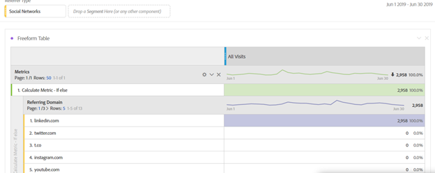

Hi Laurab,
I've tried creating a calculated metric using 'if' statement (see the screengrabs) & in this case I've taken referring domains as a dimension with visit metrics & it seems to be working fine. You can use the similar logic & see if it's working for you.
M

Former Community Member
Hi Please see an example below: i can not get each section to work only the first 2 for scheme 2 and 3, thank you
thank you i have added my example below
