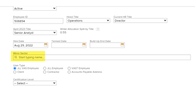

Can anyone help me with the text mode required to pull a custom form field that sits on the user profile that also is a typeahead field of the group?
I am looking to add this "Minor Sector" field as a column in a task report.

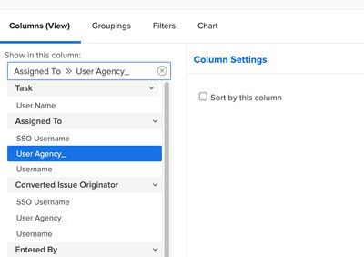

There may be no need for text mode as assignee attributes appear on task reports in the "wizard" mode.
Here is an attribute (calc field, not typeahead) that appears on a user form attached to the assignee of the task:
