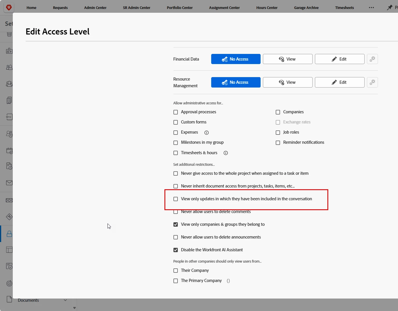

Just came across an issue with the updates area and would love to know how to fix it. When we assign folks to a project and they start to communicate with each other through updates and later another member of the team is assigned, they can't see the previous updates. Is there a way for those added later to see the previous updates commentary? Thanks, Sinead
Best answer by JustinRenteria2
Hmm this is an odd one. I dont think I've run into that before.  I believe it may be something in your configuration settings.  The only setting I could find after a quick search was the following in the Access Levels area. Id check to see if that's enabled:

Thank you @justinrenteria2 I'll take a look. Thanks, Sinead
